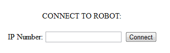

- Enter the IP number of the NXT into the box on the webpage called “IP Number”
- Press the “Connect” button on the webpage. You can watch the handshake process in your debug window.

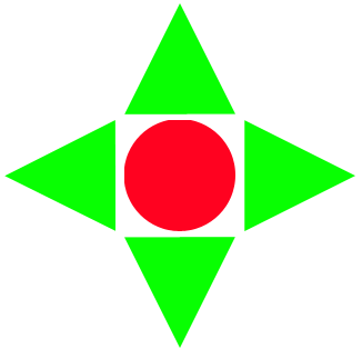

You can control forward, backward, turn and stop commands through the compass rose on the web page. You can also tell the robot too beep from the web page.
![RobotControl Direct Control of the Robot from Your iPhone](/wp-content/uploads/2012/07/RobotControl-Control_Direct-300x288.gif)
The Compass for Controlling your robot: the arrows point the robot in the direction of the arrow, the red circle is Stop.
