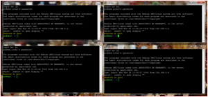

The below image shows that the commands added to .bashrc file get executed even while opening a new terminal.
Bash RC Configure systemd Run a Program On Your Raspberry Pi At Startup
