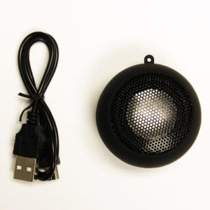

To make the Raspberry Pi Speak you need the speaker-speaker_and_usb_cable
Dexter Industries Speakers

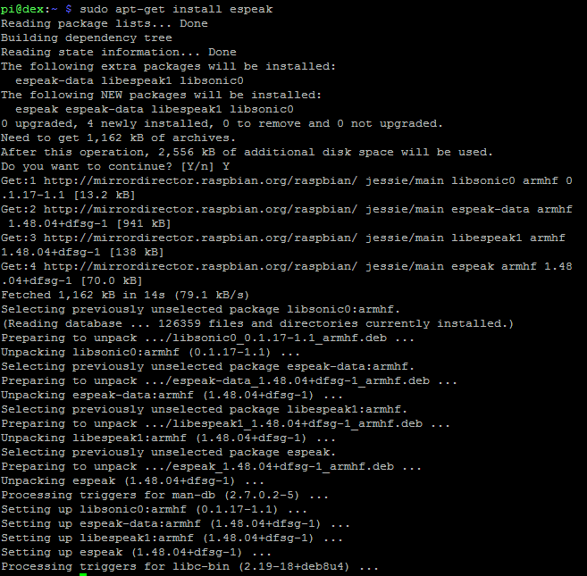

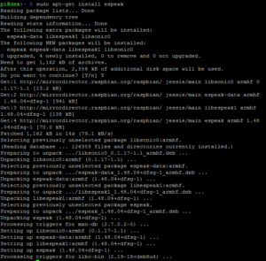

Next, install eSpeak.  Run the following in terminal to install espeak:
sudo apt-get install espeak

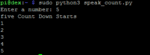

Connect your Pi to the internet.  You will need to download and install the num2words Python package to convert the numbers to strings.  This will convert an integer value to a string, which are then read aloud by the Raspberry Pi.  Use the following command:
sudo pip3 install num2words
Go to the folder where you have copied the examples and run the following command:
sudo python3 speak_count.py
Enter a number and you should hear a voice saying “Count Down Starts”, then you should hear numbers counted down from the entered number.
