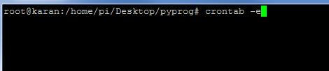

  2. Now open crontab.  You may need to open crontab in root (add sudo before the command!).
    crontab -e
    Open crontab
