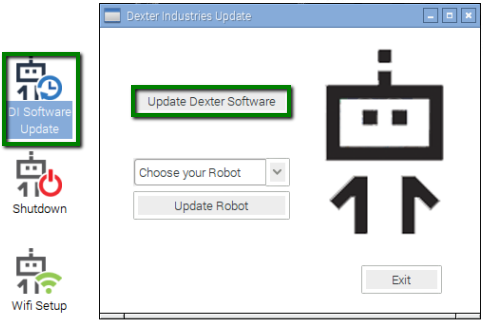

If you use Raspbian for Robots the PivotPi libraries and examples will either be installed already or you can get them by running a DI Software Update / Update Software
DI Update
