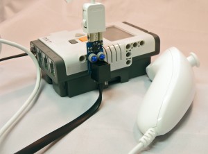

To setup the NXTChuck, simply plug it into any one of the four sensor ports on the NXT. The NXTChuck will work on any of the four sensor ports.

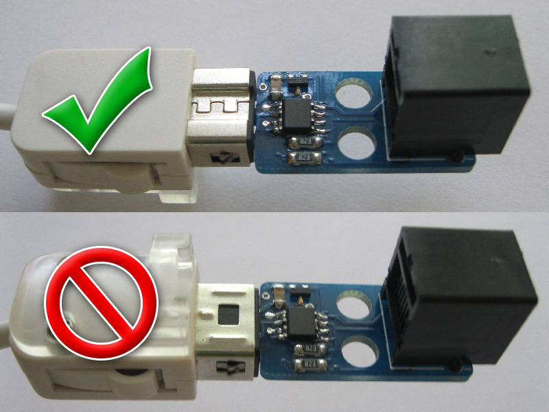

- Ensure proper orientation: confirm that the Nunchuk plug is properly connected.
- Prevent stress damage to the board: be sure to use both of NXT holes to mount to LEGO robot.
- Mounting Holes: LEGO crosses can be used to mount the NXTChuck to your robot.
Warning, improper orientation of Wii extension plug and NXTChuck adapter board could result in permanent damage to the NXTChuck, Wii extension, and/or possibly the NXT. Always ensure proper orientation before plugging the NXTChuck into the NXT. Refer to the image on the right for proper orientation.

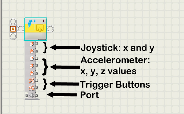

Blocks for NXT-G can be downloaded from our download section. After installing the NXT-G Blocks for the NXTChuck (see our guide on installing 3rd Party NXT-G Blocks), you should see the NXTChuck icon in the “Advanced Pallet.”
The NXTChuck Functions in NXT-G. From the block you can access the x and y-axis of the joystick, the accelerometer’s x,y, and z values, the trigger buttons and the port the sensor is connected to.

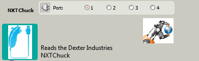

The NXTChuck Control Panel in NXT-G. Select the port the NXTChuck is on here.
