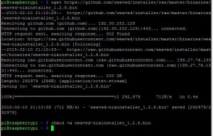

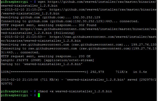

3).  Download the Weaved Software to your Pi.
wget https://github.com/weaved/installer/raw/master/binaries/weaved-nixinstaller_1.2.13.bin
(Note:  In the future this version may be outdated please visit https://github.com/weaved/installer/raw/master/binaries/
In order to see what version is the latest and substitute that version in for every ‘1.2.13’ in the tutorial.)
4).  Make the Weaved Software Executable.
chmod +x weaved-nixinstaller_1.2.13.bin
Installing and downloading weaved.
5).  Launch the Installer.
./weaved-nixinstaller_1.2.13.bin

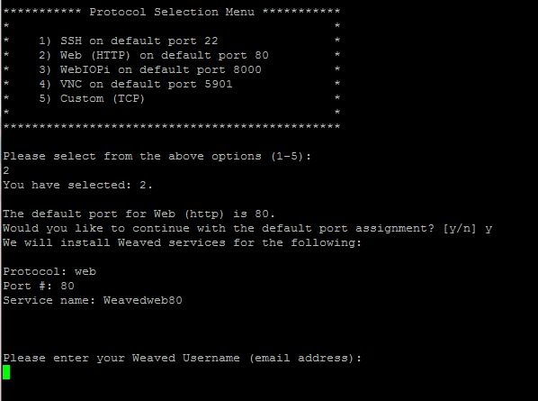

The software will run a few tests, and boom: first question.

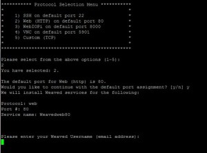

6).  Choose a service. When you first start, you’ll be asked to install one of the Weaved services:  SSH on port 22,  Web (http) on port 80, WebIOPi on port 8000, VNC on port 5091 (tested with tightvncserver), or A custom TCP service on your port of choice.
We’ll choose the second option, http on port 80.
Step 2 installing weaved on the Raspberry Pi

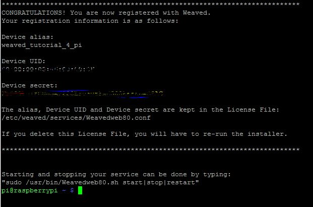

7).  Enter your Weaved Login information.
Be sure: not your Raspberry Pi login information, but the information for your weaved account (which you setup in Step 1!).
You’ll be prompted for a device name.  Name your pi wisely . . .
3 - Installing Weaved on the Raspberry Pi

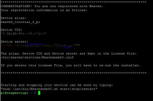

For this experiment, we chose “weaved_tutorial_4_pi” . . . and success!
Succsefuly Installing Weaved on the Raspberry Pi

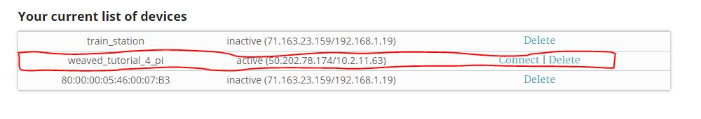

9).  Now, let’s check that the new device is online.
Go to https://developer.weaved.com/portal/members/betahome.php
We can see that the device we just setup is usable and can be connected to!

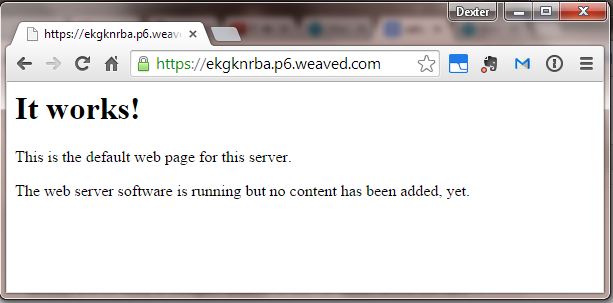

10).  Check out your website.
Click “Connect” and a new window will be opened up.  It works!  If we type in the address you see after https:// in the browser below, you can see it in your mobile phone, or from anywhere on the internet!
