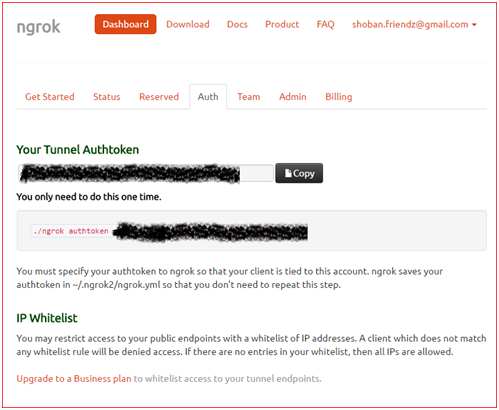

To create a ngrok account click here and then click signup to get an authtoken key. This token is necessary if you want your own custom domain doing an online SSH.
After you login to the ngrok site you will get an authtoken key which a combination of a lot characters.  You will want to keep this token secret: anyone who has this token will be able to access your Raspberry Pi.
You need to embed this token to your Raspberry Pi in the command line using:
./ngrok authtoken  yourauthtoken
Change the yourauthtoken with your own token that you get from ngrok website. You only need to this once for your Raspberry pi and it  gets stored in the configuration file.
Ex: ./ngrok authtoken qauXbmyDW8j9D

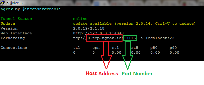

./ngrok tcp 22
If your tunnel status is “online” you can open your Raspberry Pi terminal using Putty anywhere.  Note the Host Address and the Port Number shown in the picture below; you’ll use these to access the Raspberry Pi.

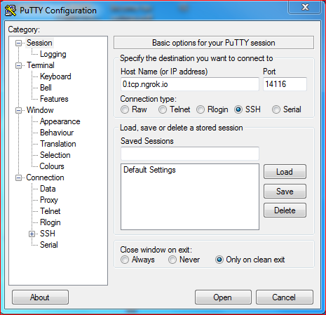

To open SSH online first open a new putty from any computer that is connected to the internet and then enter your ngrok host address and port number like in the image below and click open.
Putty Access your Pi Away From your Home or Local Network

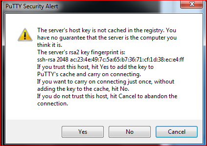

You will find a Putty Security alert window, when you try to access your Pi from remote for the first time, asking your consent to store the rsa2 key in its cache for future reference. Click Yes and proceed.

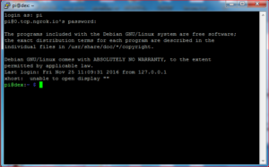

Now you have your computer connected to your Pi away from your home/local network.
Putty Access your Pi Away From your Home or Local Network access your Raspberry Pi from outside your home or local network

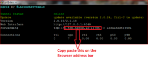

./ngrok tcp 8001

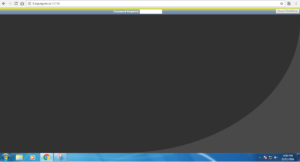

If your tunnel status is online then you can open your raspberry pi terminal using noVNC on a browser from anywhere.  Open a browser in any computer or mobile phone that is connected to internet and type the address marked in the image onto  the browser’s address bar.
NoVnc Access your Pi Away From your Home or Local Network access your Raspberry Pi from outside your home or local network
You will see a window prompting to enter the password for the Raspbian for Robots image. The default password is robots1234. Type the password and press Enter.

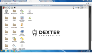

Now your computer is connected to your Pi away from your home/local network and you can access the files using the noVNC.

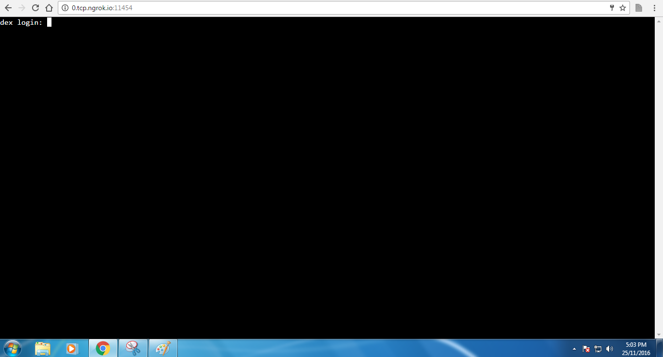

Type the following command to access Shellinabox terminal remotely:

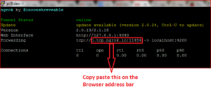

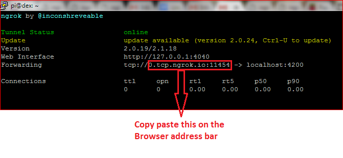

./ngrok tcp 4200

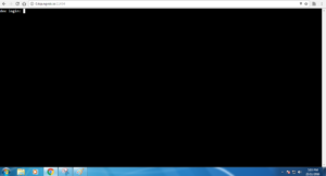

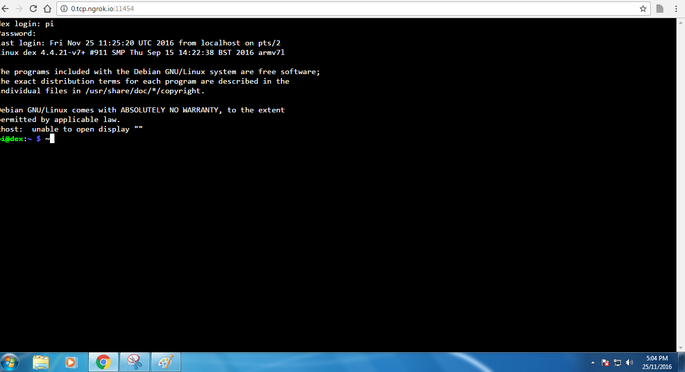

If your tunnel status is online then you can open your Raspberry pi terminal using Shellinabox on a browser from anywhere.Open a browser in any computer or mobile phone that is connected to internet and type the address marked in the image onto  the Browser’s Address bar.

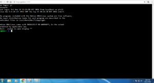

Shellinabox Access your Pi Away From your Home or Local Network
You will see a window prompting to enter the login id and password for the Raspbian for Robots image. The default login id is Pi and the password is robots1234.
Now your computer is connected to your Pi away from your home/local network and you can access the files using Shellinabox!
