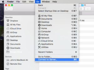

To connect your Mac and Raspberry Pi for file transfer, first open “Finder” on your Mac.
Transfer Files between your Mac and Raspberry Pi
In the picture above, we’re looking at the file system on your Mac.  Click “Go” and click “Connect to Server . . . “.

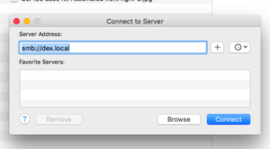

You will be prompted for a Server Address.  This is the address of your Raspberry Pi.  In our tutorial, we are using Raspbian for Robots, and the default server name is “dex.local”.
Connect to dex.local with your mac

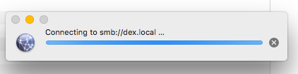

In the “Connect to Server” dialog, enter “smb://dex.local” into the Server Address, and click “Connect”.
Transfer files between your Mac and Raspberry Pi

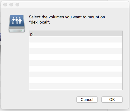

Select the volume we want to mount.  This should be “pi”.

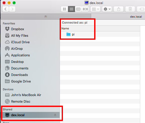

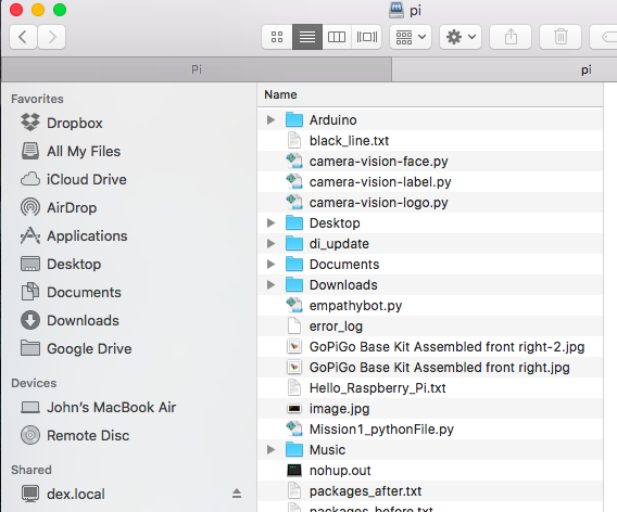

After connecting, on the left hand side of the Finder window, you should see a new category, “Shared”.  Under that category, you should now see “dex.local”.
Shared drive on the Mac and Raspberry Pi
Now click “dex.local” and you should see the folder “pi”.
mac-7-the-directory-pi-is-visible-on-the-mace

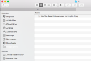

Double click the “pi” directory and you should see a list of files.
mac-8-double-click-pi-and-see-the-files-in-the-home-directory
You can now do three things with the files on your Raspberry Pi:
  • You can transfer files from your Mac to your Raspberry Pi by dragging and dropping them into the pi directory.
  • You can transfer files from the Raspberry Pi to the Mac by dragging and dropping them into a folder on your Mac.
  • You can directly view and edit files on your Raspberry Pi: simply click on the file and it will open in the appropriate program.

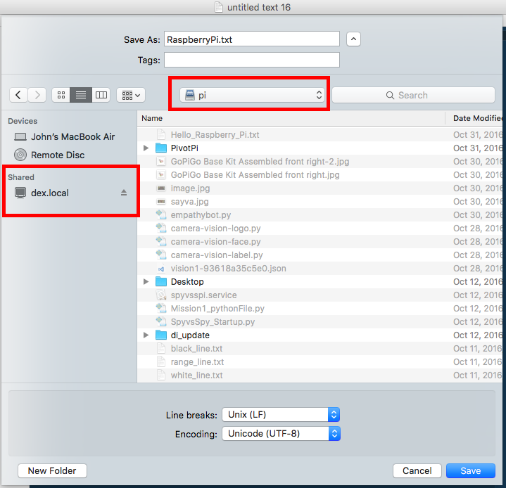

Finally, a quick tip: you can save files to the Pi using the file dialog box on a particular program.  For example, using a text editor on your Mac, you can save the file as, and select the dex.local directory.
