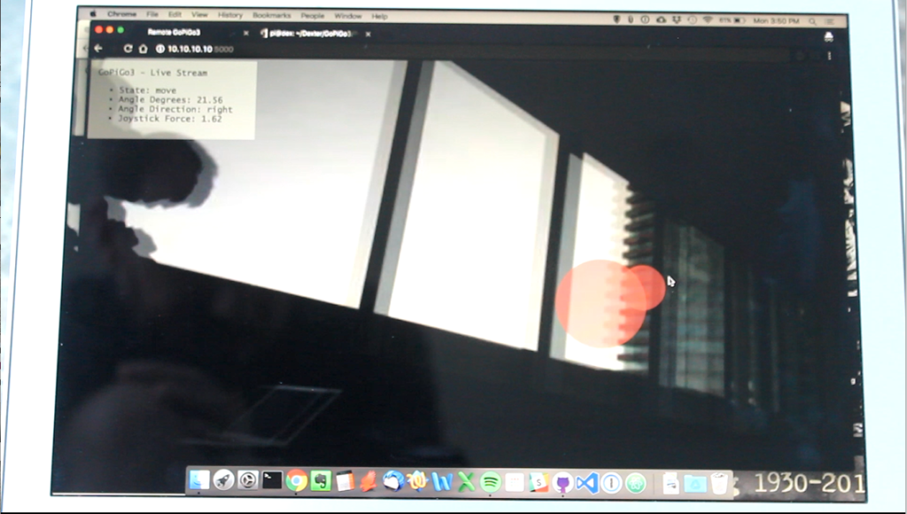

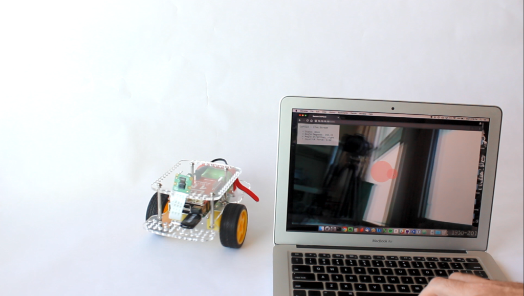

In this advanced project with the GoPiGo3 we build a Browser video streaming robot which streams live video to a browser and can be controlled from the browser.
In this project we use a the Raspberry Pi Camera module with the GoPiGo3. You can control the robot using the a controller on the browser as the live video streams directly on the browser. The video quality is very good and the latency of the video is low, making this ideal for live video streaming robot projects.

Connecting the Camera module
Attach the Raspberry Pi camera module to the port on the Raspberry Pi.  For more details on how to attach the camera, see our tutorial here.

Running the Project
Start the server by typing the following command:
sudo python3 flask_server.py
It’s going to take a couple of seconds for the server to fire up. A port and address will be shown in there. By default, the port is set to 5000.
If you have Raspbian For Robots installed, then going to http://dex.local:5000 address will be enough.   Be sure you have your mobile device / laptop on the same network as your GoPiGo3. Otherwise, you won’t be able to access it.
