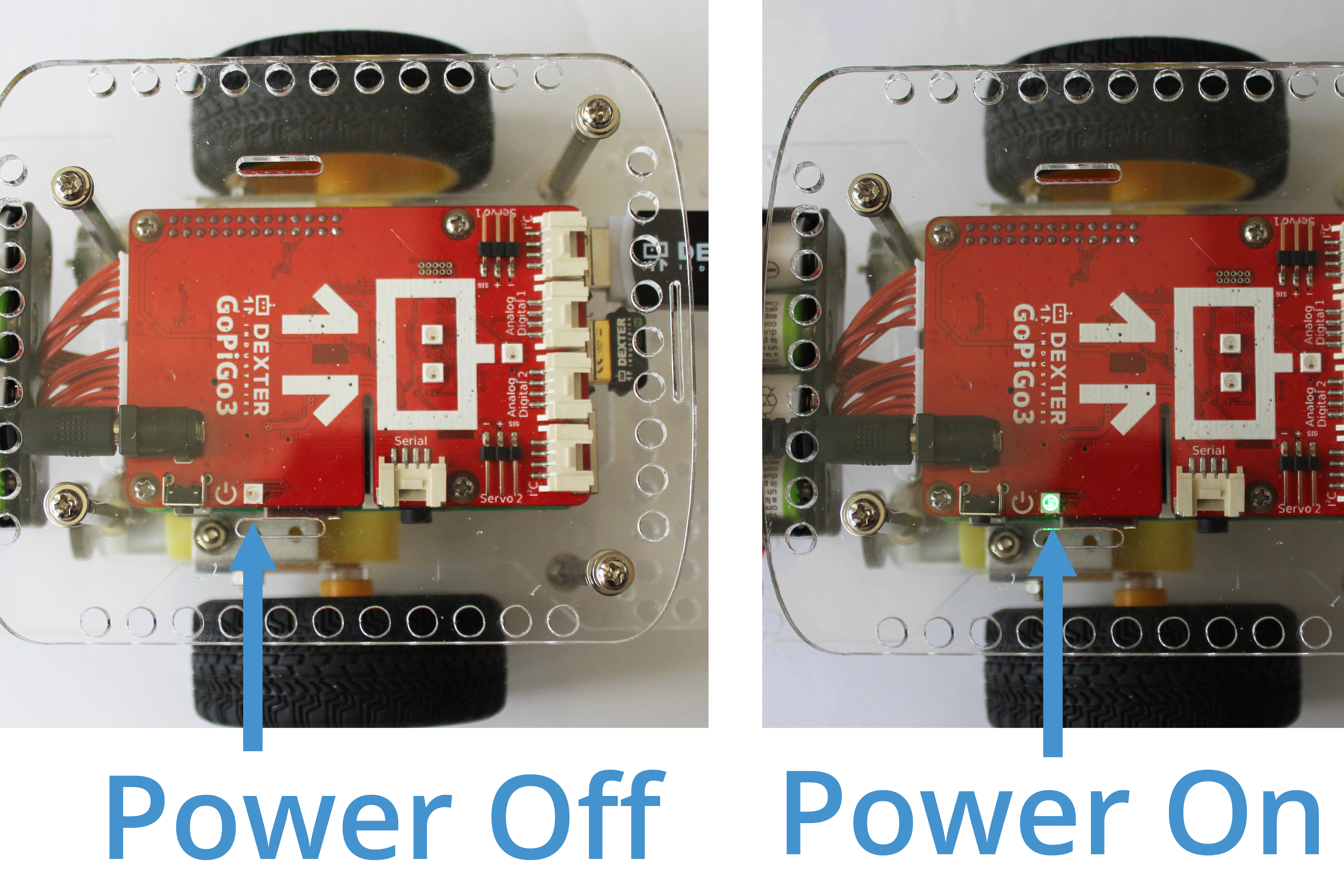

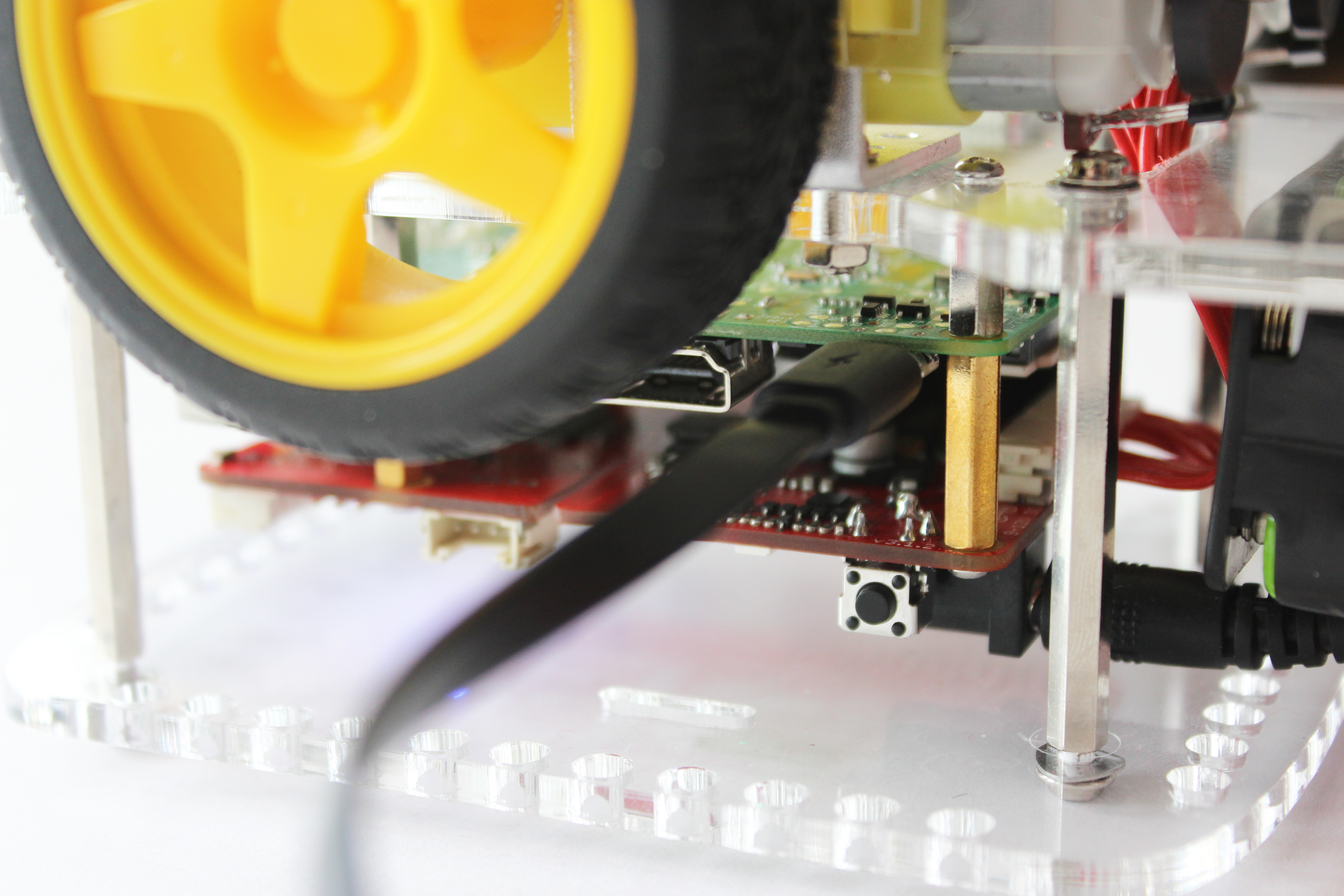

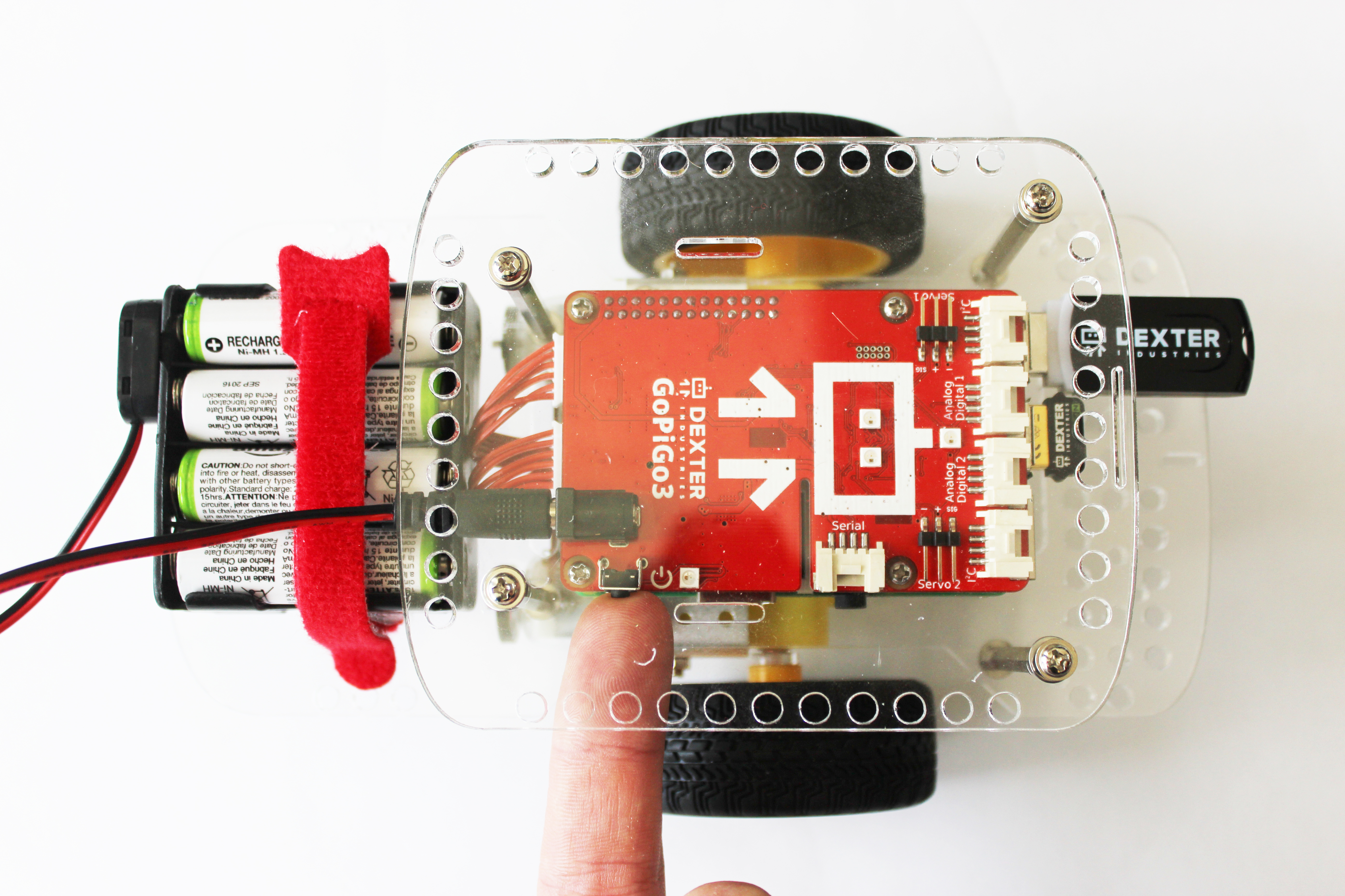

  • Press the power button located on the GoPiGo (red board) located next to the battery cable jack.

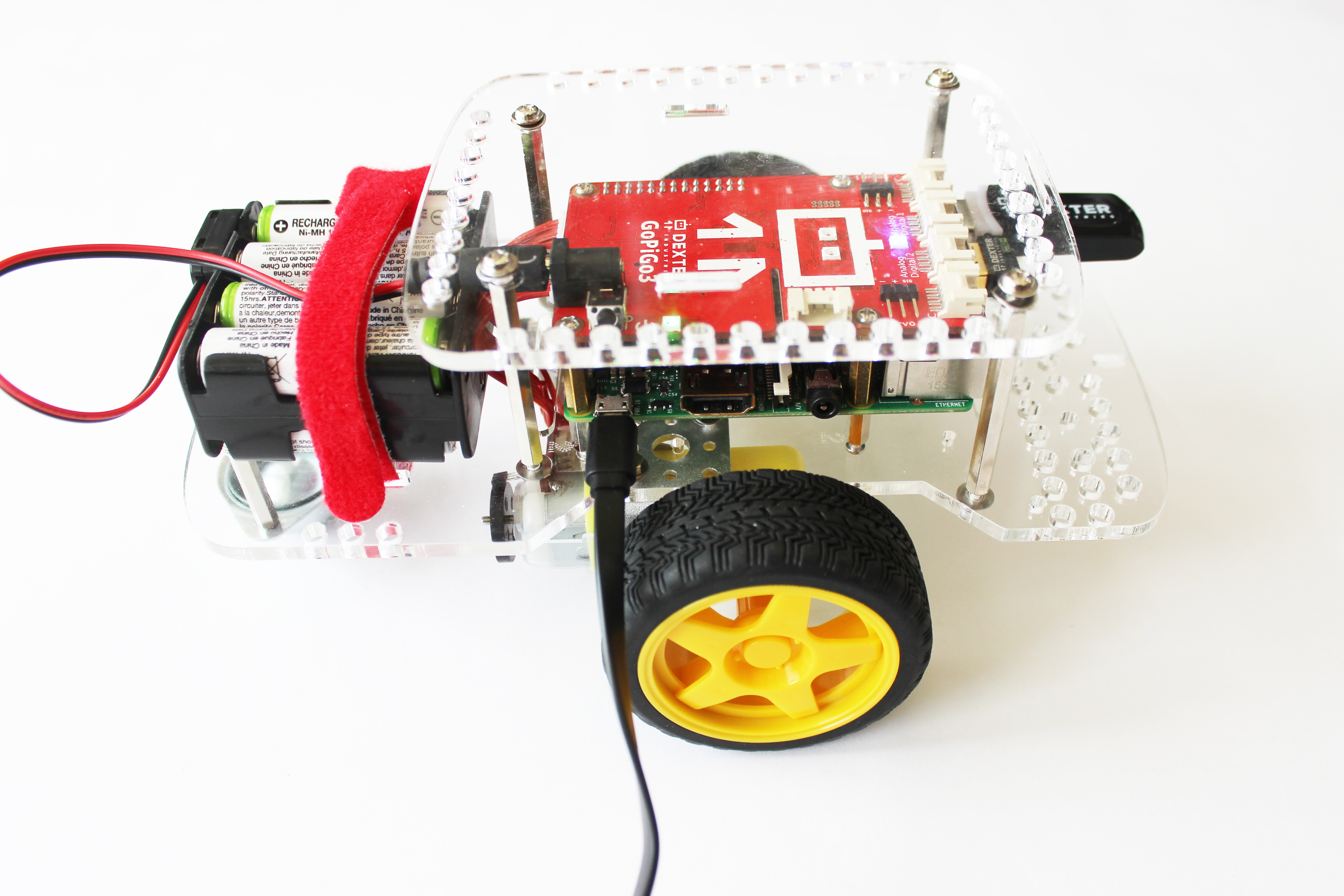

  • If you are using DexterOS:  When the power button is pressed, the LED next to the button will blink green as the robot powers on, and will turn solid green when it is full booted up and ready to go. (for more details on how the power LED acts, see below, after the picture)
Power LED Details:
With batteries only (no USB):
  • Off: Power LED is off.
  • Turning on (pressed power button, but Raspberry Pi isn’t booted yet): GoPiGo power LED flashes (color indicates battery voltage).
  • When GoPiGo is on (RPi is booted): Power LED solid (color indicates battery voltage).
  • Turn GoPiGo off (pressed power button, but Raspberry Pi isn’t fully shut down): Power LED flashes red, then turns off when Raspberry Pi is shut down.
With USB power adapter directly to the Raspberry Pi (with or without batteries):
  • Raspberry Pi booting up: GoPiGo power LED is flashes (color indicates battery voltage).
  • Raspberry Pi already booted: GoPiGo power LED solid (color indicates battery voltage).
  • GoPiGo power button was pressed and Raspberry Pi booted (turning off): Power LED flashes red.
  • GoPiGo power button is pressed and Raspberry Pi is shut down: Power LED flashes purple (Raspberry Pi and GoPiGo both try to turn off power). Since the power is coming from USB, there’s no way to actually kill power (other than unplug the USB power).
Regarding the color that indicates battery voltage, it will be red (low voltage), yellow (moderate voltage), or green (good voltage).

You can shut down your robot by pressing the power button again.  You will see the power LED begin to blink red and it will shut off.
