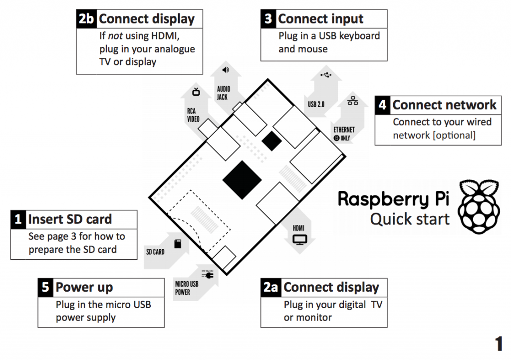

Option 2: Set up without a computer (need a monitor, keyboard & mouse)
RPi_quick_setupThe bullet proof option is to use a monitor, mouse, and keyboard. The BrickPi case is designed to allow space for a keyboard, monitor, and mouse.  You may find that you need a USB hub to add a Wi-Fi device to the BrickPi.  The advantage of this configuration is that you don’t have to configure the Wi-Fi on the Raspberry Pi, or login remotely on the computer.
For more information on this, we recommend browsing the Raspberry Pi Foundations Quick Start Guide.
