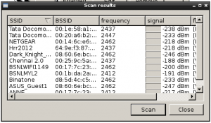

Click the “Manage Networks” tab and click the “Scan” button.
manage_networksClicking “Scan” reveals all of the different Wi-Fi networks available.  Double click the network you want to connect to. You should choose the same network that your computer is currently on.
SSID_Scan

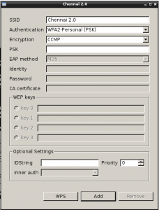

If the wifi you selected has a password, enter that password in the “PSK” field. Click the “Add” button.
Network_Info
This window will close, but if not, just close it and also close the “scan” window. You will see the first window again and click on the “current status” tab to see if your wifi network is selected. Wait a few minutes (sometimes this can take up to 5-10 minutes) to see if it connects, and final confirmation of a connection is when you see an IP address show up. If it doesn’t connect after a few minutes, go back to Manage Networks, Scan and select the network again — retype in the password because that is usually the problem.
