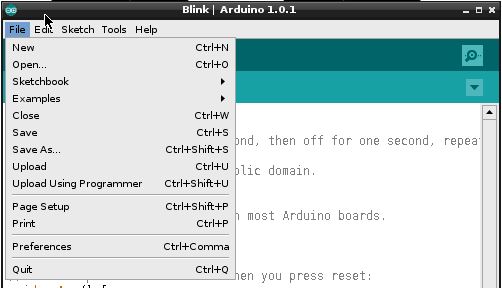

 Step 2: Open the Example Arduino Sketch
Open an example or an Arduino sketch that you want to upload.

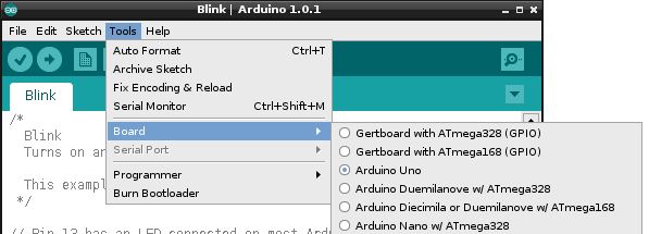

 Step 3: Set the Programmer
Make sure that the programmer is set to Raspberry Pi GPIO and the board is set as Arduino Uno.

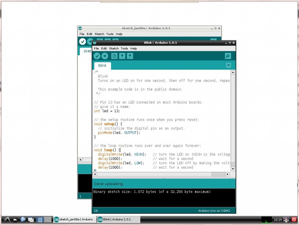

Step 4: Upload
Click Upload. If Upload does not work use Upload using Programmer (Ctrl+Shift+U) to upload the sketch to the Arduberry

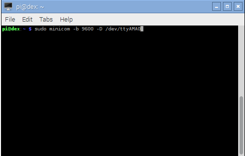

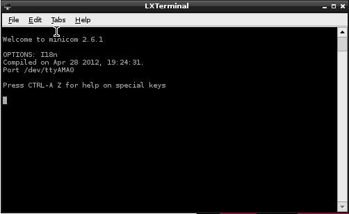

Minicom is configured to a default baud rate of 9600.  To open minicom at 9600 baud, enter the following in terminal:
sudo minicom -b 9600 -D /dev/ttyAMA0
Starting Minicom with 9600 Baud
Arduberry and Raspberry Pi minicom at 9600

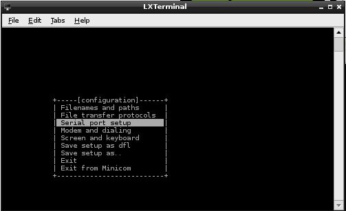

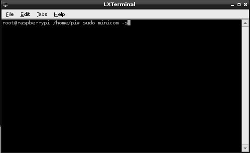

If you want to use minicom in any other baud rate than 9600, open minicom in terminal with the following command:
sudo minicom -s
minicom_setup

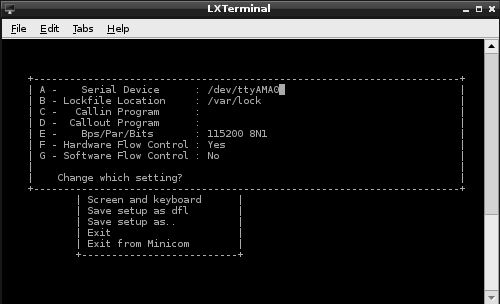

Select the “Serial Port Setup“:
minicom_serial_setup
Press “A” to change the device to “ttyAMA0“, “E” to change the baud rate, “F” and “G” to change the flow control. Press Enter to go back to the main menu.
minicom_serial_setup 2

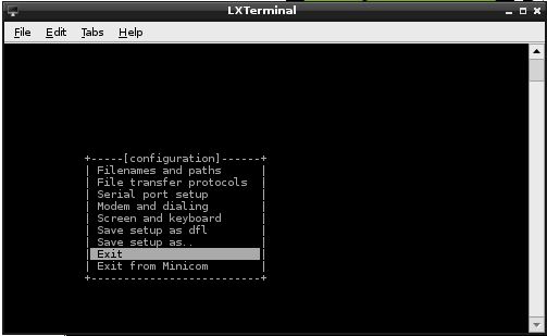

Select Exit to start minicom in the new configuration.
minicom_exit

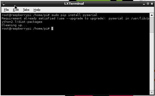

To access the Serial data coming from Arduberry in Python, install pyserial.  Note: if you used our setup script to get started here, you have already installed pyserial.
sudo pip install pyserial
pyserial

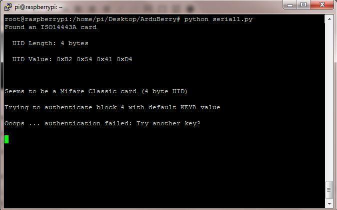

Write a small program in python to access the Serial data
import serial
ser = serial.Serial('/dev/ttyAMA0', 115200)
while True:
         print ser.readline()
Save it and run it.
python serial

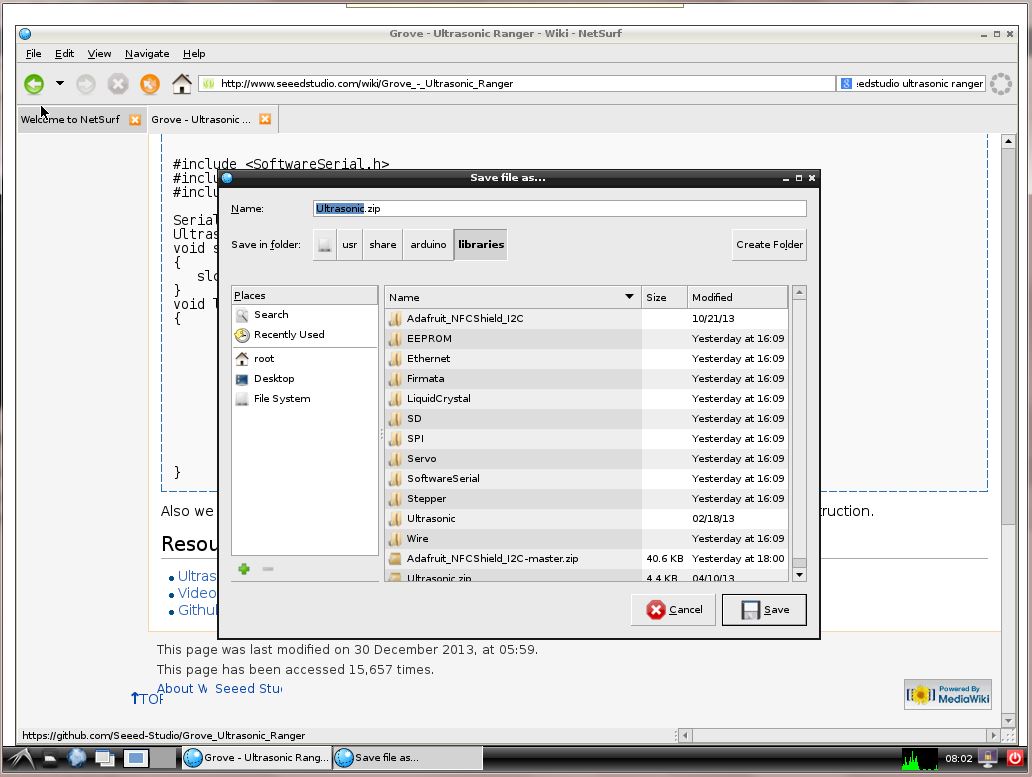

Adding a New Arduino Library
Download the new library in Raspberry Pi using the Netsurf browser.
Save the library to /usr/share/arduino/libraries/
lib_dwld

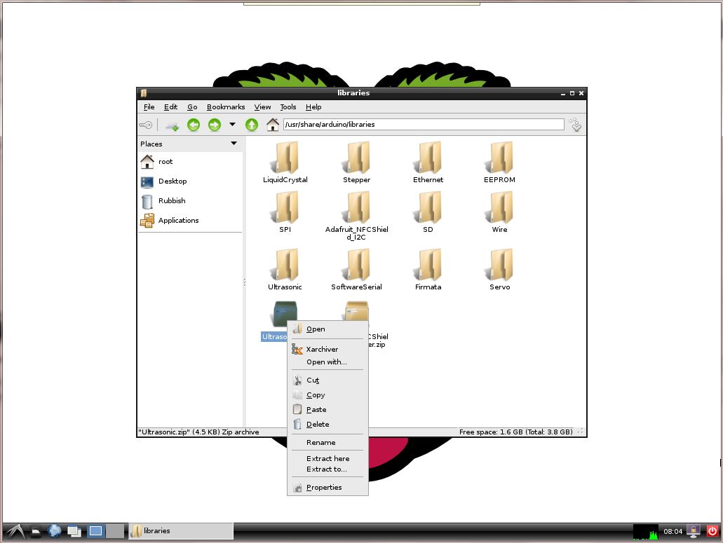

Open /usr/share/arduino/libraries/ in the File Manager.
Extract the library in the same directory.
extract

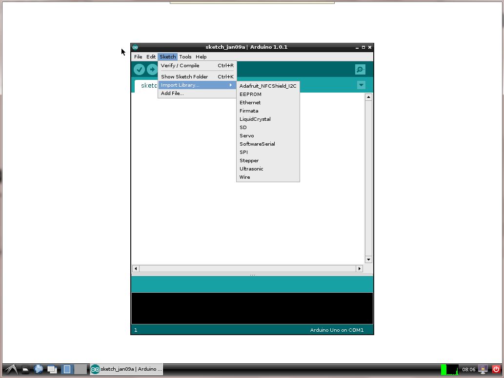

Now the new library can be used in the Arduino IDE
lib_imported
