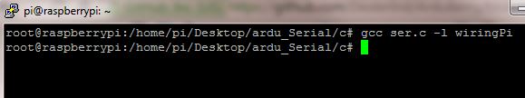

Compile the C program:
 gcc ser.c -l wiringPi
compile

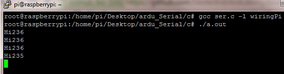

and run the C program and the data should start coming on the terminal:
./a.out
c_run
