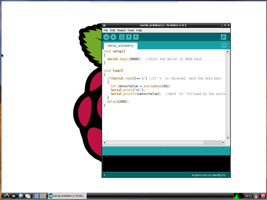

Step 2: Upload the sketch to Arduberry
Open the Arduino IDE on the Raspberry Pi, and open the serial_arduberry.ino in the Arduberry Github Repository .
arduino_prog
Choose the programmer as Raspberry Pi GPIO and the board as Arduino Uno.
To upload the sketch to the Arduberry, use “Upload as a Programmer” or press “Ctrl+Shift+U“.

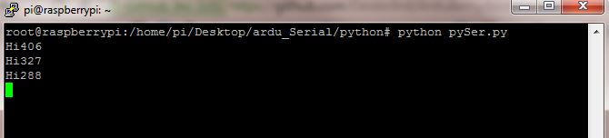

We have created a sample Python program which sends a command to the Arduberry and reads a string and an analog value back from the Arduberry.
Run the Python program and the data should start coming on the terminal:
python pySer.py
python_op
You can modify this program and the Arduino sketch to send or receive any data, to and from your Python program.
