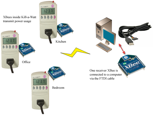

In a nutshell, this thing takes an off-the-shelf Killawatt, which monitors electricity use in individual appliances, wirelessly delivers the data to your computer, and then posts it online. Check out a better description here. The Killawatt itself will tell you how much energy an appliance is using; but with the modifications, we can aggregate the data all over the house, store the data on the computer, and even Tweet it (because we’re really sure a lot of people want to know how much energy we’re using). Thus Killawatt becomes Tweetawatt. This could have a lot of real-life uses (and even better, save you some money!), but again, we just wanted to learn more about XBee Technology and Python scripting.

The Killawatt kit assembled. You can see the XBee transmitter tucked inside. This chip sends the data being gathered by the Killawatt.
The modified killawatt, with XBee inside. The green LED lets us know it’s functioning properly.
Some pictures of the receiver. This plugs into a USB.
