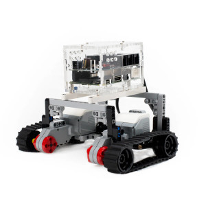

BrickPi+ Assembled TankSupported Sensors and Motors
