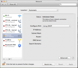

2. Setup your Ethernet Preferences
After clicking “Open Network Preferences”, select your Ethernet connection on the left hand side of the box. Check that you have “Using DHCP” selected for “Configure IPv4” option. And check that “Location” at the top of the dialog box has “Automatic” selected for your network configuration.

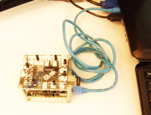

3. Setup the Hardware.
Plug one end of your ethernet cable into the ethernet port on the Raspberry Pi, and the other into your computer ethernet port. On your MacBook Air you may need and ethernet cable adapter.
Next, power the BrickPi3 up by attaching the battery pack or the wall power adapter — then turn the power switch on the BrickPi3 to “on”. You should see the “PWR” LED solid, and the “ACT” LED on the Raspberry Pi begin to blink (not solid). The lights on the ethernet port of the Raspberry Pi should turn on.

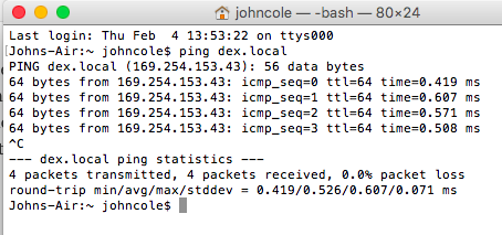

4. Test for Connection
To test if your Pi is connected on the network open the Terminal program on your Mac and use the command line. If you don’t know where the Terminal program is, use the finder and type “Terminal”. The program is also located under Applications/Utilities in most Macs. In the command line type:
ping dex.local (then hit enter)
If there is a response that keeps printing out numbers like above it means that you are connected to your robot! Stop this by pressing “ctrl-c”. Close out of Terminal.
If you do not get a response, please visit our forums for help connecting your Mac and BrickPi.

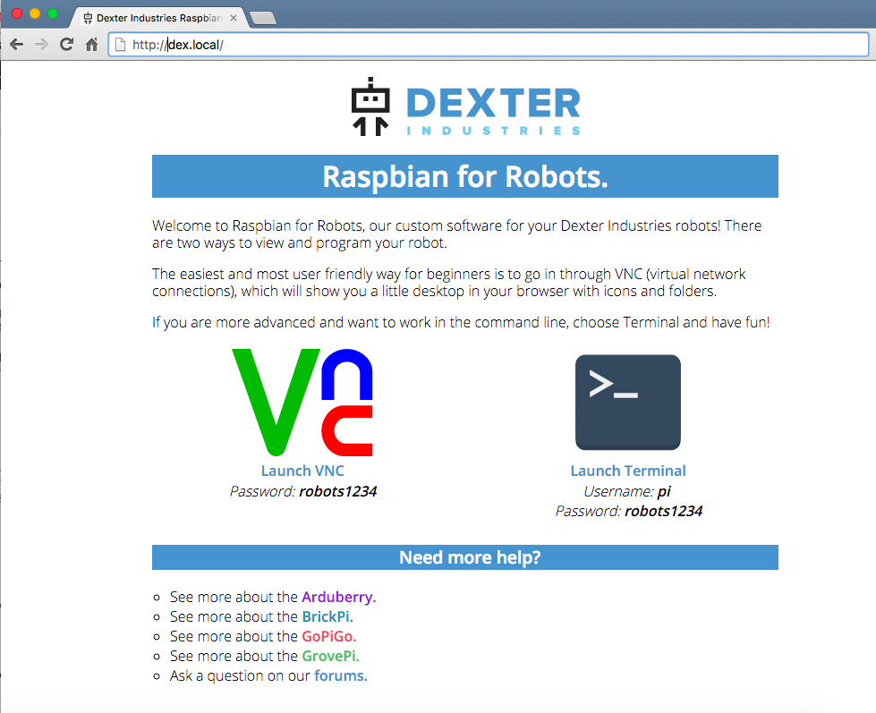

5. Connect to your BrickPi Using a Web Browser

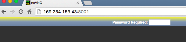

Open a web browser window (Chrome preferably). Go to http://dex.local (if you just type in dex.local, some browsers will search for dex.local. Be sure to type in “http://dex.local”, and be sure to include the “http://”). Tip: If this doesn’t work, go to “10.10.10.10:8001”.

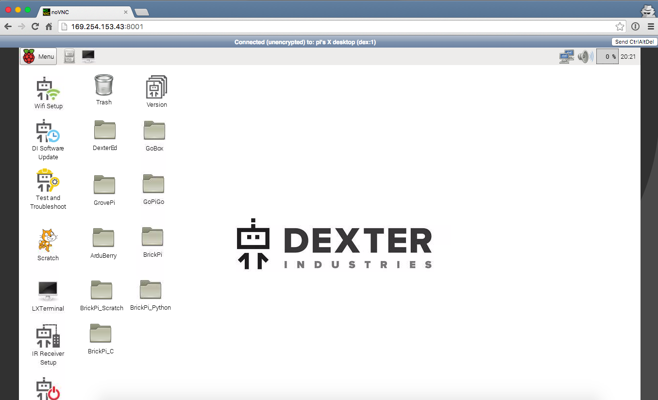

Choose “VNC” by clicking on the icon that says VNC. You will be prompted for a password at the top of the screen. The password is “robots1234” + enter.
After logging in, you should see the Dexter Industries Desktop.
Now you’re ready to setup Wifi on your BrickPi!

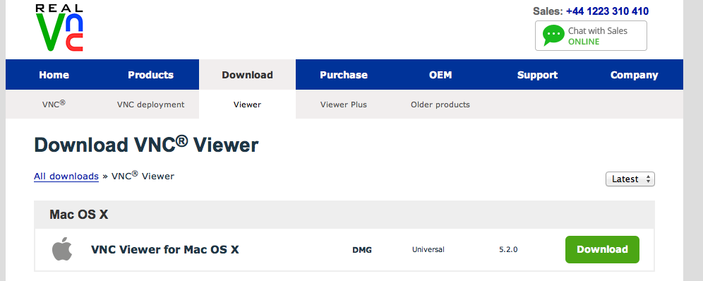

First, install VNC Viewer on your Mac. VNC Viewer is free. You can download VNC Viewer here.
Click download on the “VNC Viewer for Mac OS X”. You will be prompted for a name and e-mail address.

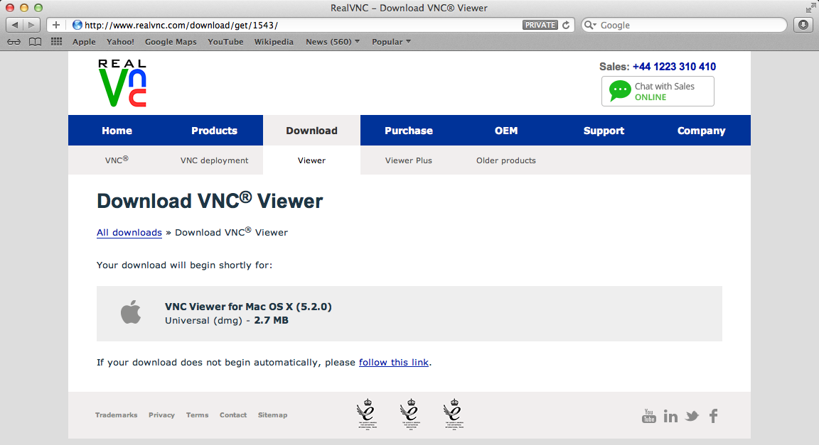

Agree to the terms and click “Download”.
Install VNC Viewer by double clicking on the downloaded file.

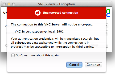

Finally, continue through VNC’s warning message about the un-encrypted connection.
When prompted for the password, the password is “robots1234” Congratulations! You’re in!
