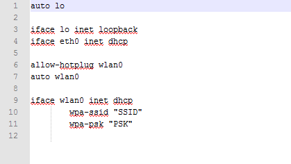

interfaces_fileWe have developed a more convenient way to set this up using a USB drive.  You simply put your network information in a file in the root directory of your USB.  Here’s a step-by-step:
  1. Open the example file in the BrickPi/Image directory in github here.
  2. Copy the file “interfaces.dat”.  Open in WordPad on your Windows computer, or your preferred text editor on the Mac.  Do NOT open in Windows text editor as the formatting will be destroyed.
  3. The file should have the SSID, PASSWORD, IP address and other configurations necessary to make a connection to a WiFi network.  Change these to the appropriate values to connect to your WiFi network.  (You can quickly see your network settings in the Windows command line by typing “ipconfig” in Windows).
  4. We recommend adding a static IP address so you can log directly onto the Raspberry Pi over WiFi.
  5.  Save the file to the root directory of a USB thumb drive, as “interfaces”.  This should not be interfaces.txt, or interfaces.dat, it should be “interfaces” (no extension).
  6. Remove any WiFi dongle from your Raspberry Pi.
  7. Place the USB thumb drive in your Raspberry Pi and power it up.
  8. Let the Raspberry Pi setup the interface.  It should automatically reboot after about 2 minutes, and restart.  After waiting 2 minutes, remove the USB thumb drive.
  9. Insert your wifi dongle into the Raspberry Pi.
  10. Your Raspberry Pi should now automatically connect to your wifi network.
Note: This operation will be performed only on boot.  This will not work if you first start your Raspberry Pi, and then insert the pen drive.
Note: If this operation is successful and the WiFi information is correctly setup, it will delete the interfaces file from your dongle.
