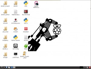

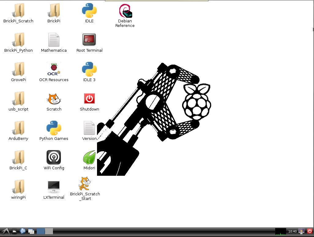

Step 3: Click on “BrickPi_Scratch_Start”
On your Raspberry Pi desktop, there should be an icon called “BrickPi_Scratch_Start” that looks like the Scratch Cat.  Click this icon.
Raspberry PI_Desktop with Scratch

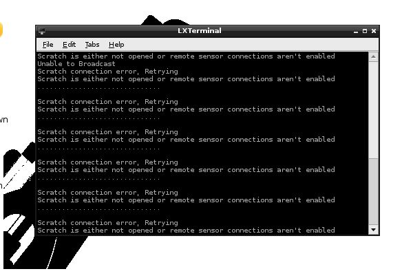

You’ll see the terminal window open.  Do not close this window.  If Scratch is not running, you’ll see an error “Scratch connection error, Retrying”.  Not to worry.
BrickPi LEGO Robot Scratch is started but not connected

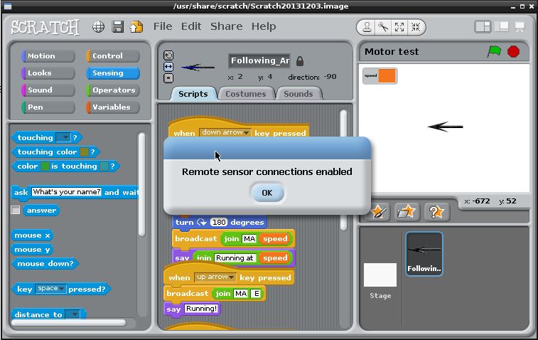

Step 5: Open an Example Project
In Scratch, go to File, Open . . . and select the examples from the directory “Desktop/BrickPi_Scratch/Examples”   After opening one of the examples, you should see a dialog box open in Scratch that says “Remote sensor connections enabled.”
If we check back to our terminal screen we started with the BrickPi_Scratch_Start button, we should see that a connection has started:  the screen now says “Connected to Scratch successfully”.   Try running an example program to see how it works!
