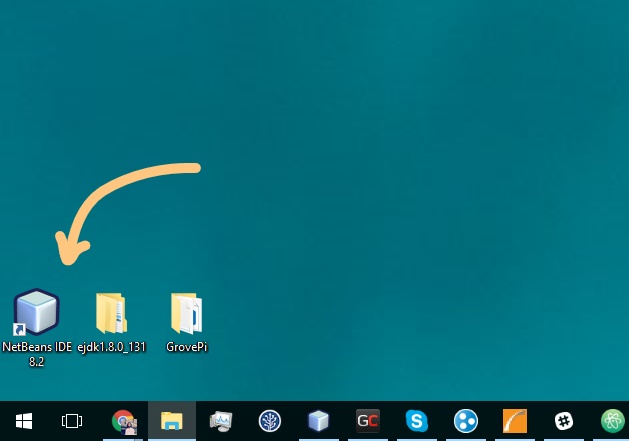

Open Netbeans IDE from your laptop’s Desktop.

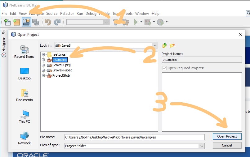

Open the examples project. On your laptop, navigate to Desktop/GrovePi/Software/Java8 and open the examples project.

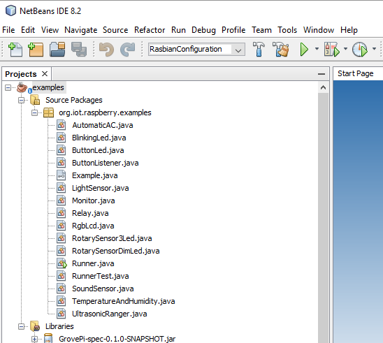

Now, let’s examine the example programs we can run.  Inside Netbeans IDE, go to examples/Source Packages/org.iot.raspberry.examples and see all the java files containing our example programs.
By clicking on the java files, tabs open up and you start seeing the implementation of each example program side by side. Give them a good read and try to understand what each example program does. Files like Runner.java & Monitor.java are not example programs, but they’re the underlying software that makes everything to run.
