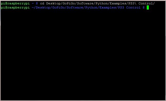

  1. Go to the PS3 Control folder:
     cd Desktop/GoPiGo/Software/Python/Examples/PS3 Control/
    Open the PS3 controller example folder

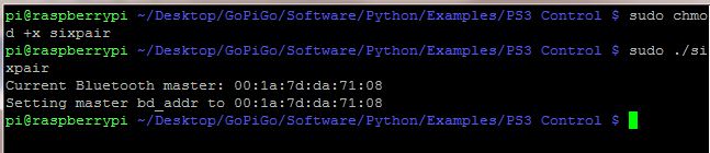

  2. Make sixpair executable and run it .This will pair the PS3 controller to the Bluetooth adapter.
    sudo chomod +x sixpair
    sudo ./sixpair
    Disconnect the USB cable which was connected to the PS3 controller.
    Pair the bluetooth with the PS3 controller
