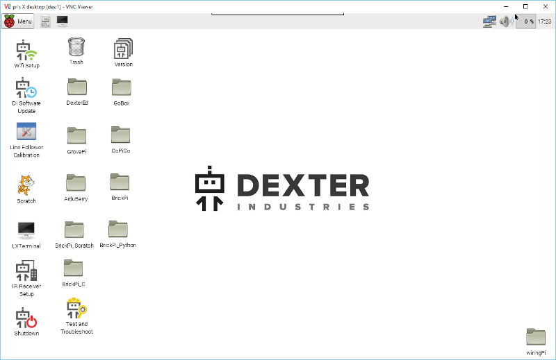

Start Scratch for Robots
Double click the “Scratch” icon on the desktop (identified here with the green arrow) to start Scratch for Robots, the program which communicates between the GoPiGo and Scratch.
This will open two windows, a black terminal window called the Scratch Controller and the Scratch for Robots interface. Do NOT close the Scratch Controller, as that will kill all communications between Scratch and the robot!

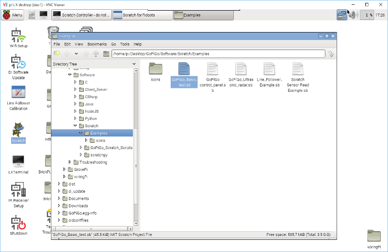

Start Basic Test
Double click the GoPiGo_Basic_test.sb in the Examples window.
GoPiGo_Basic_test

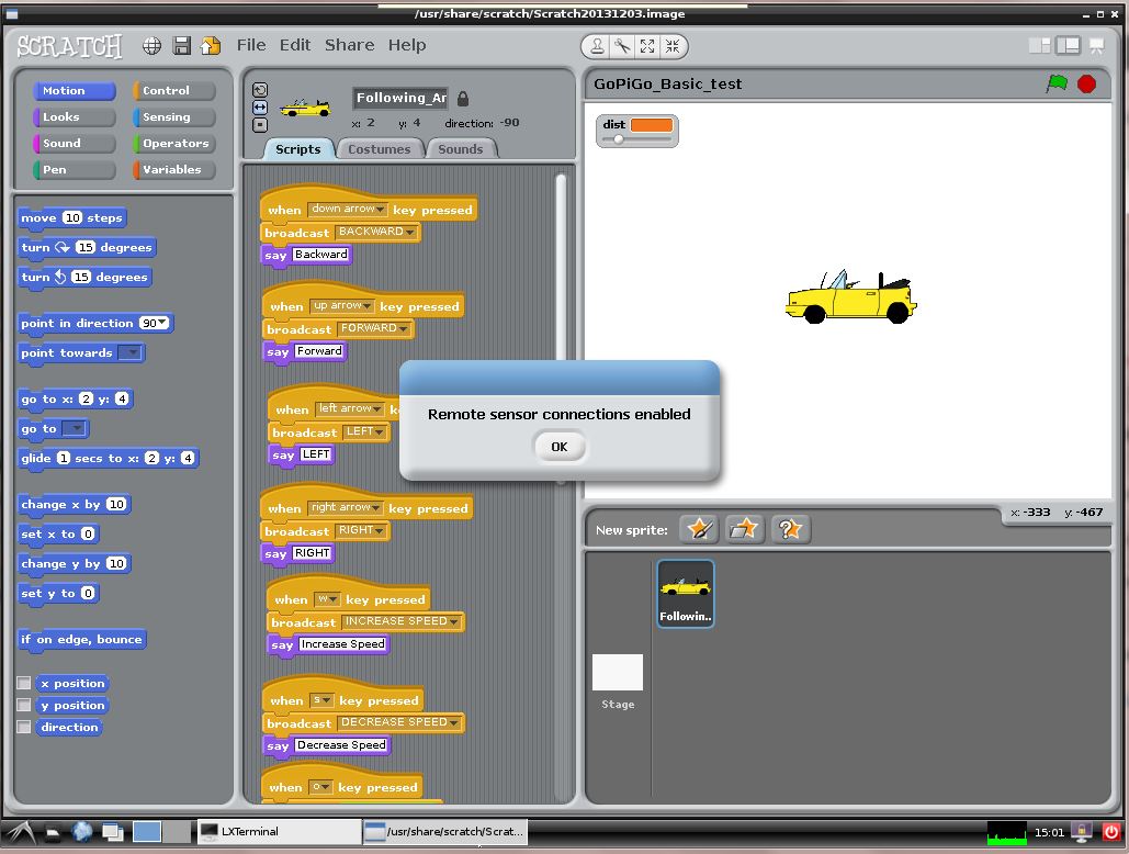

Confirm the next window that will pop up and Scratch will start up!
You should see Remote sensor connections enabled popup after loading the example. This means that the program is now connected to the GoPiGo.
remote_conn_en

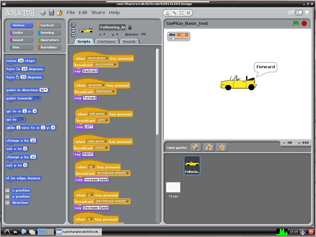

Running the program
Press the Green Flag on the top right corner to start the program. To control the GoPiGo, press:
  • Up arrow– move forward
  • Down arrow– move back
  • Left arrow– turn left
  • Right arrow– turn right
  • w-Increase speed
  • s-Decrease speed
  • o & p – control left LED
  • k & l – control right LED
  • Space– stop
basic_example_running
Stop the program once you are done by pressing the Red Flag.
