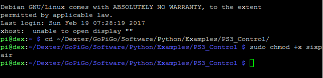

  2. Next, connect your PS3 Controller to the Raspberry Pi, using the USB cable.  In the command line, make the program “sixpair” executable and run it.  This will pair the PS3 controller to the Bluetooth adapter.
    sudo chmod +x sixpair
    sudo ./sixpair

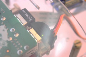

  3. Disconnect the USB cable which was connected to the PS3 controller.  Press the PS button on the PS3 controller (this is the round button in the middle, between the “Select” and “Start” button on the controller) and a couple of random buttons on the controller. The light on the Bluetooth adapter should become solid green from the blinking green earlier.PS3 Control of the Raspberry Pi with GoPiGo

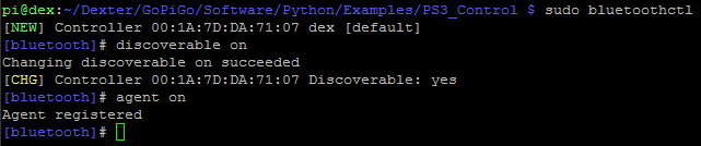

  4. Start the bluetooth pairing method:
    sudo bluetoothctl
    discoverable on
    agent on

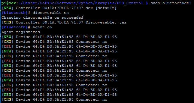

  5. Now, still in the bluetooth program, start to press buttons.  You should see something like this:
    [bluetooth]# agent on
    Agent registered
    [NEW] Device 64:D4:BD:3A:E1:95 64-D4-BD-3A-E1-95
    [CHG] Device 64:D4:BD:3A:E1:95 Connected: no
    [DEL] Device 64:D4:BD:3A:E1:95 64-D4-BD-3A-E1-95
  6. Note down the mac address of the device.  In our case, it’s 64:D4:BD:3A:E1:95

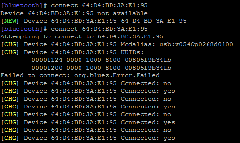

  7. Run the “connect” command, followed by the bluetooth mac address of your device. In our case, this will be connect 64:D4:BD:3A:E1:95
  8. Finally, set the device as trusted.  We’ll use the “trust” command:  `trust 64:D4:BD:3A:E1:95`

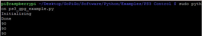

Start the PS3controller example :
After pairing your PS3 controller with the Pi, we’re ready to run our code.
 cd ~/Dexter/GoPiGo/Software/Python/Examples/PS3_Control/
 sudo python ps3_gpg_example.pyRun the Ps3 Controller example
