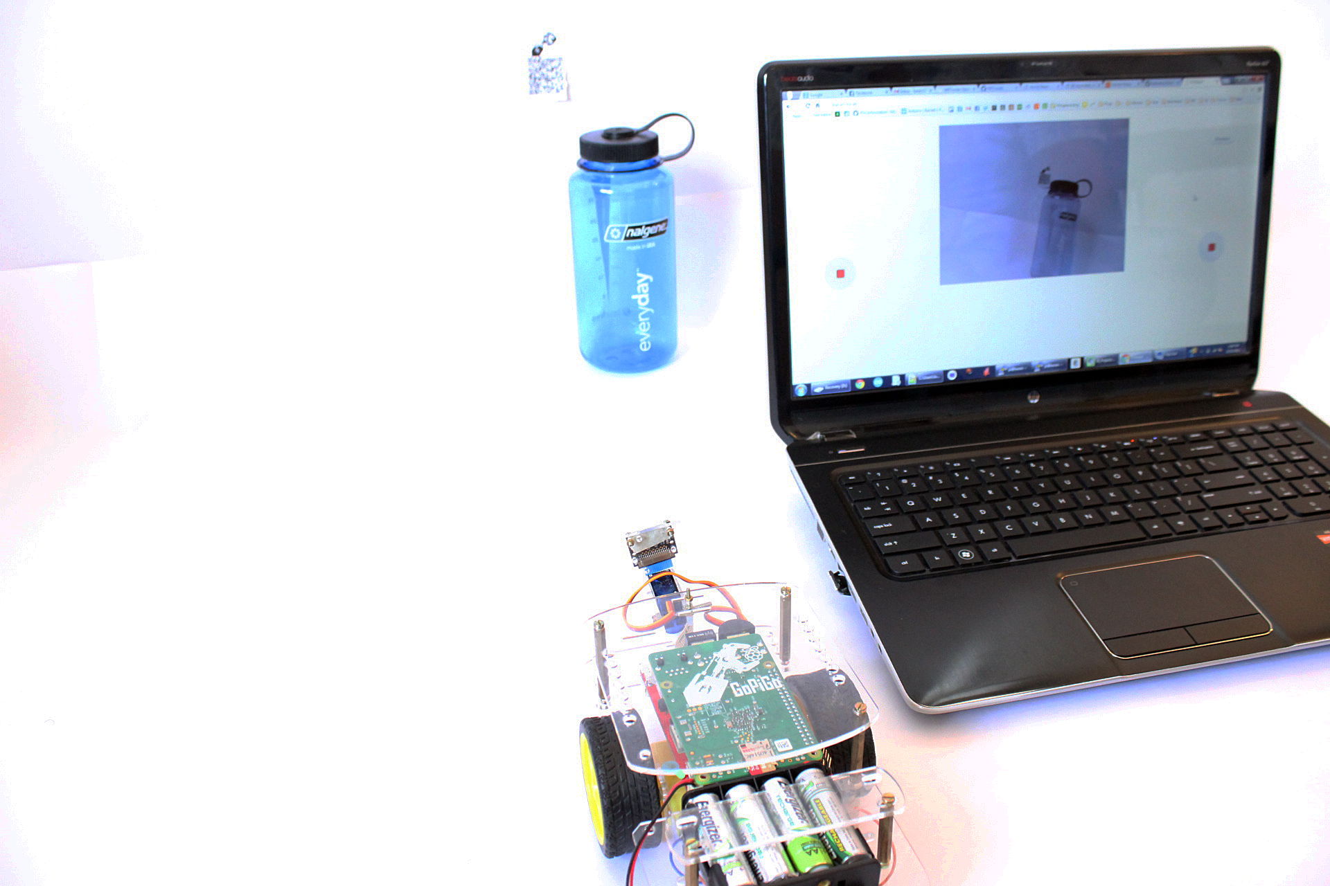

This is an advanced project with the GoPiGo to create a Browser streaming robot which can stream live video to a browser and can be controlled from the browser too .
In this example we use a the Raspberry Pi camera module with the GoPiGo. You can control the robot using the joysticks that appear on the browser and can see the live feed directly on the browser too. The video quality is very good and the latency is also very less so this project can be ideal for live video streaming robot projects.

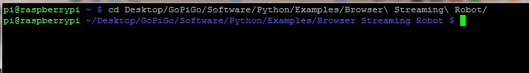

  1. Go to the Browser streaming example folder:
    cd Desktop/GoPiGo/Software/Python/Examples/Browser Streaming Robot/
    Open the example folder

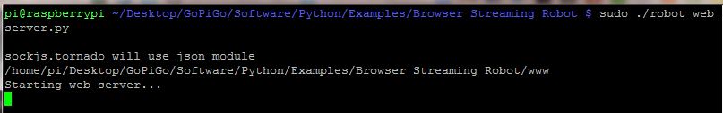

  3. Start the robot_web_server.py to start streaming the video from the camera module
    sudo ./robot_web_server.pyStart streaming from the script

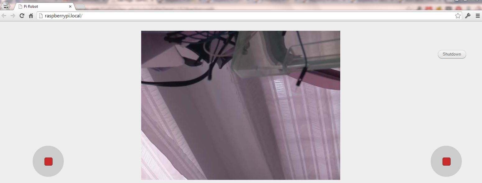

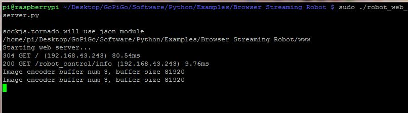

  4. Now open the browser and enter dex.local in the browser and hit enter to start streaming. You’ll also see some activity in the terminal.Browser streaming using the Raspberry Pi camera and the GoPiGo starts the stream as soon as the browser logs on to the Ip address

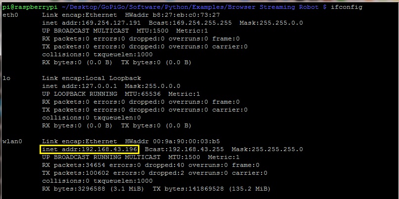

  5. You can also stream it on a mobile device. Make sure that the device is connected on the same WiFi network. Open the browser and enter the IP address of the Raspberry Pi to start streaming the video.
    Finding out the ip address of the GoPiGo using ifconfig to stream on a mobile device
    Finding out the IP address of the GoPiGo using “ifconfig” to stream on a mobile device
