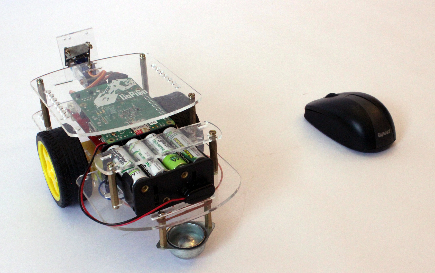

This project shows how control the GoPiGo with a wireless mouse.
The GoPiGo moves in the same way as the mouse. If the mouse is moved left, the GoPiGo moves left, if the mouse is moved right, the GoPiGo moves right, if the mouse is moved up, the GoPiGo moves forward and when the mouse is moved down, the GoPiGo moves back. Left mouse button stops the GoPiGo.

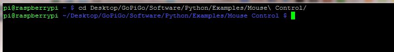

  1. Open VNC and go to the Mouse control example folder:
      cd Desktop/GoPiGo/Software/Python/Examples/Mouse Control/
    Open the mouse control robot folder

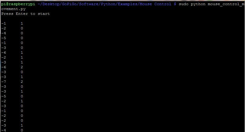

  2. Start the mouse_control_movement example
    sudo python mouse_control_movement.py
    Start the programPress Enter when you are prompted.

    You can see the mouse movement in the X and Y directions. When you move the mouse fast enough, the GoPiGo will start moving around. Press Ctrl+C to stop.
    Mouse movement output
    Mouse movement output in the X and Y axis
