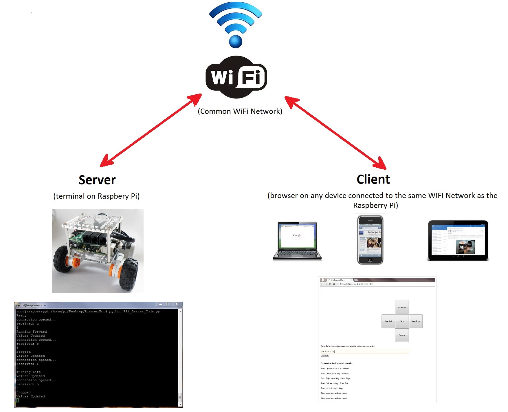

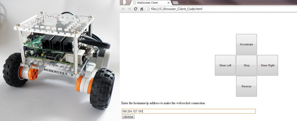

The browserBot” is a web-browser controller robot using the BrickPi.  With this project, we demonstrate how to control a BrickPi robot directly from the browser of any computer, tablet, or phone.
Raspberry Pi Robot Controlled with a Web Page
Using the browserBot you can build your own web-controlled robot in very very easily with just a few lines of code. The browserBot is a good place to start if you want to build a project using BrickPi to send and receive information directly to a web page.
browserBot infographic: How the Raspberry Pi is controlled by your tablet.

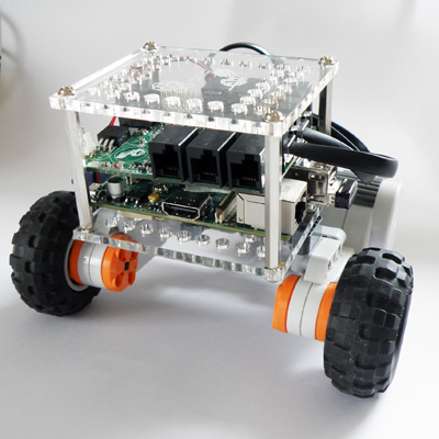

Building the browserBot
The browserBot uses the same body the simplebot .  Here are some links for building instructions:

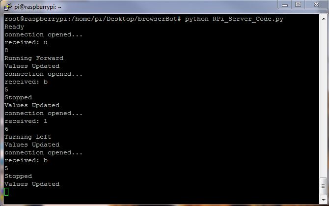

Once you’re connected and have Tornado installed on the RaspberryPi, run RPi_Server_Code.py in terminal on the Raspberry Pi:
python RPi_Server_Code.py
browserbot_server

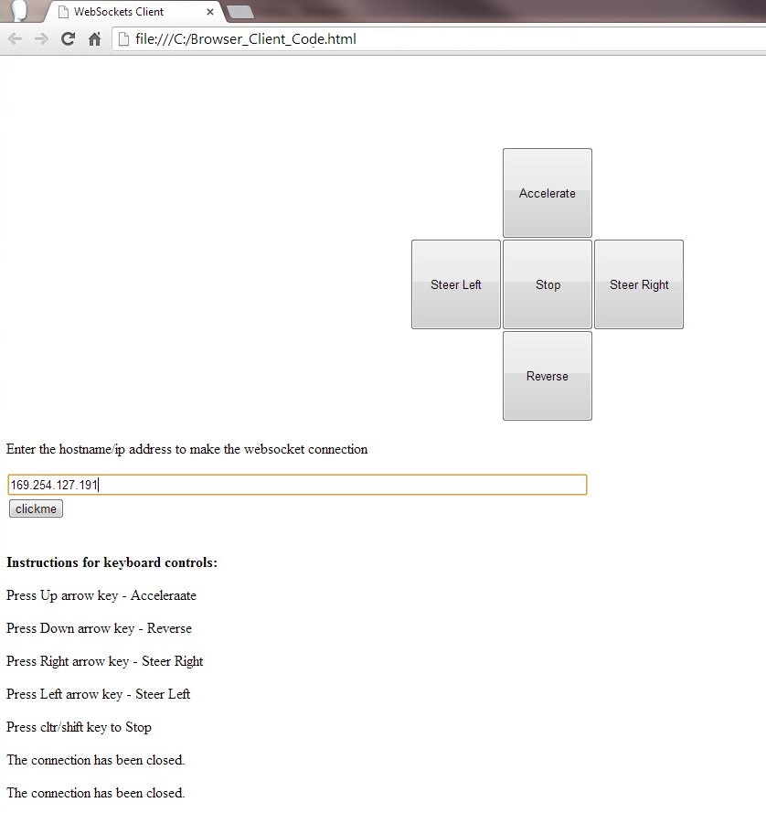

After the server is running on the Raspberry Pi, download Browser_Client_Code.html from the BrickPi Github Repository to the device you want to control the browserBot from.
Run the client code Browser_Client_Code.html in the web browser of any device such as a laptop or a Mobile Phone as long as they are on the same network as the Raspberry Pi.
Once the HTML page it loaded, enter the BrickPi’s IP address into the text box and press “clickme”.  There will be a short lag as the browser connects to the Raspberry Pi, and then you should be able to control the browserBot with the buttons on your web page..

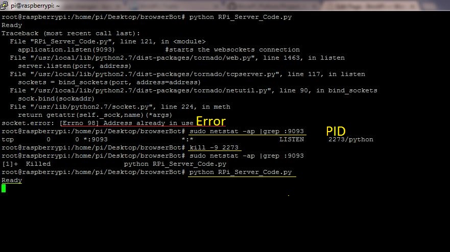

Errors and Troubleshooting:
If you get the following error:
socket.error: [Errno 98] Address already in use
Run netstat on the terminal and check which process is currently using the port 9093:
sudo netstat -ap |grep :9093
troubleshooting
Note down the PID (Process IDentifier) of the process running it and kill that process :
kill pid
If it does not work use:
kill -9 pid
If the error does not go away, try changing the port number ‘9093’ both in the client and server code.
Tip:Don’t use Ctrl+Z to stop the program, use Ctrl+c.
If you use Ctrl+Z, it will not close the socket and you won’t be able to run the python server on the Raspberry Pi the next time.
