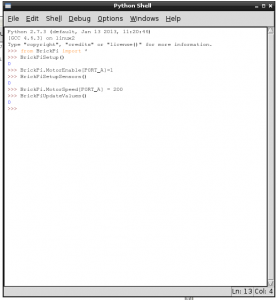

Example: Run a motor.
Enter the following into IDLE:
from BrickPi import *
BrickPiSetup()
BrickPi.MotorEnable[PORT_A] = 1
BrickPiSetupSensors()
BrickPi.MotorSpeed[PORT_A] = 200
BrickPiUpdateValues()
Motor_Example_In_Raspberry_Pi_IDLE
