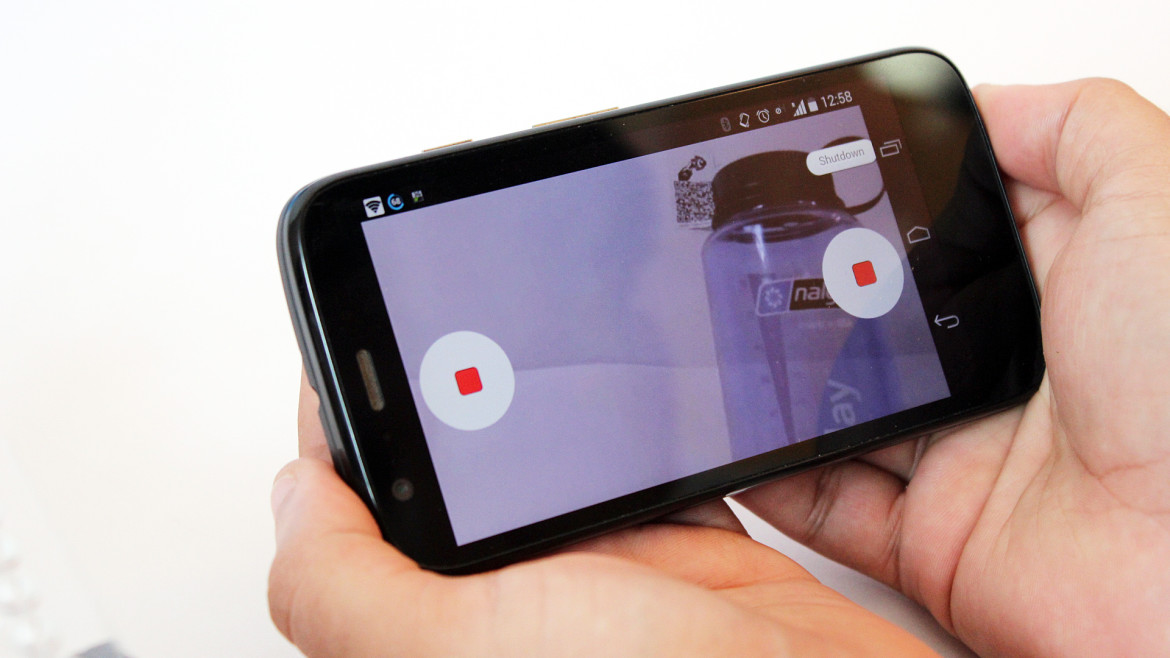

In this example we use a the Raspberry Pi camera module with the GoPiGo. You can control the robot using the joysticks that appear on the browser and can see the live feed directly on the browser too. The video quality is very good and the latency is also very less so this project can be ideal for live video streaming robot projects.

  4. Now open the browser and enter raspberrypi.local in the browser and hit enter to start streaming. You’ll also see some activity in the terminal.
  5. You can also stream it on a mobile device. Make sure that the device is connected on the same WiFi network. Open the browser and enter the IP address of the Raspberry Pi to start streaming the video.
