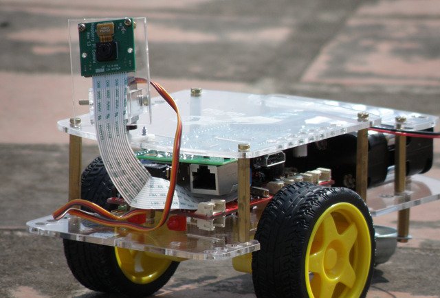

This project shows how to use the Servo with the GoPiGo with simple keyboard commands. You can try out his example to see how the servo works with the GoPiGo and adapt this program to make it work with you own projects. The servo can be used with the Ultrasonic ranger or the camera to have a pan/tilt functionality with the GoPiGo.
 Hardware needed:
  • A fully assembled GoPiGo
  • Wifi Adapter for connecting and controlling
  • A Servo with the custom cabling for the GoPiGo
Connecting the servo:
Connect the servo connector to the 3 pin header between the two LED’s in the front.
